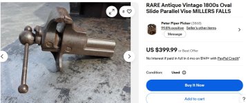

That's a real beauty! I'm thinking Miller Falls, if this Ebay listing is accurate.
Twagler. thanks for your reply and citing the E-bay post. That e-bay sure looks identical to mine, but without a maker's mark, I'm still curious about establishing value. Nonetheless, I am happy to add to my vintage shop/machine collection. best, Edmund.

Twagler, after some further research today, I'm convinced it's a Chas. Parker. Gonna give it a good bath in vinegar and use it well.
Best, Edmund.
twagler
Jun 29, 2016
101
Ottawa, Canada
I think you are likely correct, and that the ebay listing was a mis-identification. I took a quick look at some of the Millers Falls catalogs that are available on the VintageMachinery website, and your vise has certain features that did not match those images. Have you found a catalog image and specific model number of a Parker that matches?
