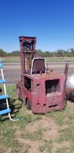

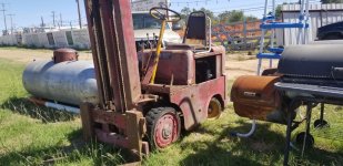

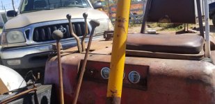

I looked at this today, everything works, needs new tires and probably some charging work. Sellers asking $1200, indoor use only for me. Any idea on model/year? Thank you.

Tires are expensive. If it runs and no leaks etc it may be worth it. I picked up a newer running no leaks 70s clark for 2500. I see them for 2 to 3k in good condition all the time.
rsanter
Dec 22, 2007
18,505
visalia ca
I just bought a running (runs poorly) 1979 Clark forklift for $1500.
That one is very very vintage, unless it runs good (very good) I don’t think I would bother at that price.
I’m starting to lear just how expensive it can be to have any work done on a forklift.
And as for tires, if it is just for your own occasional use I would not replace the tires if they are not causing an issue

Probably a 2k or 3k rated unit from the 60's. by the time you haul it, put tires on it and catch up all the maintenance, you're into the same $ as a 5k unit that doesn't need anything.

You may think you will be indoor only, but you'll want to get outside and pull something off a truck, and then the little warehouse ones are stuck, and if its in mud, they are really stuck.
Go for something with pneumatic tires. You'll find it much more useful. I own both styles, and the little warehouse one I own is nice in the building, but I would sell it before my outside capable forklift.
$2,500-3,000 will put you into a decades newer lift, and one with a roll bar. I got a buddy a nice 90's clark a year or two ago for around $2,000, and its a nice lift.

50s/60s, not worth that in that shape w/out good rubber. Paid 500 for a bigger, better shape gaser than has only needed a tube and a tuneup so far.
lis2323
Dec 25, 2016
3,234
It’s up to you but I would definitely pass. Around here the seller would be laughed off the planet for trying to get more than scrap price.
Others have given good advice. You will be better served spending a little more money for a better one.

You didn't say what you were using it for but unless you have a lot of space that will be a pain in the *** to maneuver inside. There are much smaller lifts with plenty of capacity which will be much more usable. Also side shift is nice. I would stay away from early Clarks unless they are really nice. Those continental motors are notorious for blowing head gaskets

I probably wouldn't give $500 for the OP's forklift. Buy one from the 80s or 90s for a bit more money and you'll get a much better machine.
The older ones have much weaker hydraulics, no sideshift, no power steering, and don't get into tight spaces nearly as well.

The OP got a Clark Clipper forklift. 2K capacity, handy as can be and might be able to fit thru a 36" wide doorframe (!!)
Ive never seen one up close & personal but I think its 40s-50s vintage. Likely flathead 4 cylinder. I would recommend usual stuff of ditch anything 6 volt and go immediately to 12volts. Ditch any generator for a 30A mini alternator and replace all of the ignition components you can.
Its probable that the mast leaks and will have to be sealed. Also be careful I don't think it has any free-lift on the mast and thus gains height immediately as the forks come up. That can damage things overhead.
