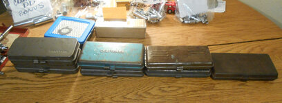

Last week, I picked up these two 1/4" Craftsman sets from the early '60's. One is missing a ratchet. The other has a long-lever style included. I have enough pieces and parts to make a complete 16 pc. set. The problem is, there are differences in the way each set was made. The boxes have different latching mechanisms, (the one on the right is older) and the extender bars (both long and short) have different finishes. One pair has a satin finish, the other a full polish. How do I match these up to the right box?
I did my homework on these before posting this. Seems the long-lever style was only made from 1957-58, but was offered in sets into the early '60's, before the butterflies.

The ratchet question aside, I'll address the question about matching the different sets with the different boxes. The short answer is, there's no wrong answer.
Sears sold millions upon millions upon millions of socket sets. Moore Drop Forge (MDF), EASCO, then Danaher had multiple factories pumping out Craftsman wrenches, sockets, ratchets, etc for decades. No one knows exactly how sets were put together but the theory I follow is that all were sent to one or more central locations to be placed in sets or labeled for individual sale. Sets were OFTEN mismatched (letter codes, finishes, even manufacturers), dating back to WWII.
The boxes were made by a different manufacturer than the tools that went into them. If you look back to 1945-48, one can find tools from 4 different manufacturers in the same style box (Plomb/Proto, New Britain/Husky, MDF, and SK), or one manufacturer in 3 different style boxes, and it was common to have mixed manufacturers in sets.
Back to your question. You can put those sets together in any way, shape, or form, and you would have a configuration that was correct.
My advice - do what makes the most sense to you!

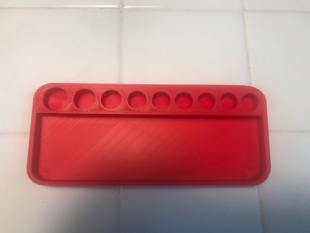

Somebody out there is 3D printing the red inserts. They're close but they don't have descending depths for each socket so the sockets end up being stair-stepped across the top once inserted in the tray (if that makes any sense). No clue who's doing it or what the source is but I've seen them in those clamshell cases from time to time in eBay sets.
Looking at some of the Craftsman tool catalogs online from the mid-1950's, those inserts were originally metal socket holders and came with box-head ratchets in the cases. Too bad they didn't continue the all-metal construction. I would have preferred that over fragile plastic.

When just the bottom of the "pocket" is broken out, I have made spacers from wood or plastic to support the socket from beneath. It isn't right, but it allows display of an open box with the sockets in the proper orientation.
Of course, the sides of the plastic pocket need to be there to locate the socket properly.

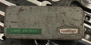

Awakening an older thread as I just purchased a similar vintage set. Mine are all stamped "V". No I am not "Corky Switzer",
The red insert on mine is also damaged. My sockets are all the same height and the original tray is not "stair stepped" or descending depths.
Has anyone bought a decent replacement?
These sellers seems to make a pretty decent looking 3D printed insert. The first one looks a little more correct with the slot running thru the socket holes.

Is there a desire for the correct replacement for these? Need a few "easy" projects for my HS students to practice reverse engineering and modeling on. I have an insert they can use as a "master".
I’m in if reasonable
I can take dimensions on mine if it helps.

Sorry, what I meant was that the students would measure an existing one, then create a 3d file in SOLIDWORKS. Probably print one or two to test tolerances, then would put the file up for free (non-commercial use). If the students wanted to "license" it, up to them.
There are a ton of these little plastic broken ones out there. If they came up with good design that closely matches original that could be done inexpensively, I'll bet a pretty fair amount would sell or get made.

I was cobbling together a set the last couple days and noticed that a "Permanex" box (for a 3/8" drive set) sold for $29.70 including shipping
That red plastic insert for $20 bucks isn't TOO outrageous when you consider people are willing to pay north of $50 for that particular 1/4" drive set.

Look at it:
dscf0978-jpg.980860
The two loops align when closed. That's a latch, just waiting for a pin.
Someone that has the "Tommy rod" and one of these sets--please try this!
Enquiring minds want to know!
30,058
no no no no.... Craftsman used two different designs of "latch" on those 1/4" drive boxes.
the one with two "ears"
and one with just a metal tab:
That 5/32" x 3" chrome-plated rod with the tiny detent ball at one end is the "cross bar", and they're rare as hens teeth.
Don posted one just above showing how it fits into the flex handle (breaker bar).
And no way would I fool around trying to jam something into those "ears" - they're just spot-welded on, and if you break it off, you've destroyed the value of the box (not to mention causing it to never close and latch properly again - ever.)
