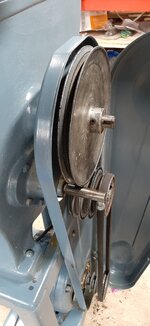

i will have to post a wider shot but trying to figure out the year of this one, and what is up with the top pully? its clearly a 4 speed but cant figure out the top top pully?
That lever switches the gearbox from the middle pulley via reduction gear to direct drive through the top pulley, where the top pulley is for wood cutting speed.
