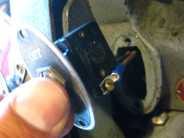

i have an old 9 inch atlas and my switch stopped working. I dont want to put some new looking plastic **** on my 30 lathe. am i gunna be stuck looking on ebay or does someone make these new? http://thatcherworks.blogspot.com/2013/08/boring-bar-lathe-attachment.html

It's easy enough to find a new toggle switch at most any hardware store that will fit in the original ON/OFF bezel plate, but you won't be able to get one with that cool little knob handle on it.
If the switch still feels like it's working but nothing happens, you may be able to revive it with a spray can of contact cleaner.

Judging by the modern crimp terminal on it now that may not even be the original switch.

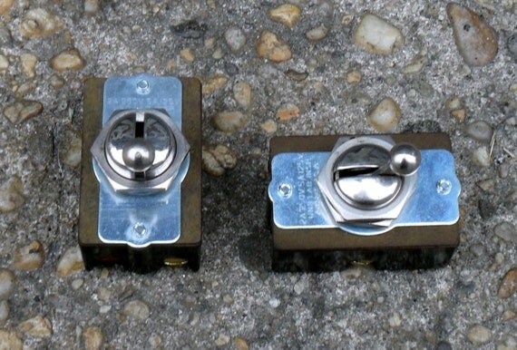

The etsy one might work. That switch prob does not handle the full load of the machine.

i ended up getting one from napa. it works but im gunna try that contact spray trick cause i like the little knob and brass one that was on there. all it does is turn on an electric motor. no reverse. thanks for the help!

NAPA? Are you sure it's not a 12V switch?

nah it was rated for 10 amps at 250. all its doing is making a connection. so far so good!

Since that one is junk I would try to disassemble and fix it. You have nothing to lose and I have successfully fixed one before.
