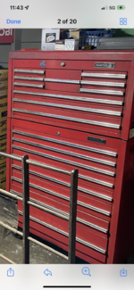

May be able to pick up this older Matco Tool Box
Person selling it doesn't know much about it.
Can anyone give me any insight on the box from the pictures?
Aprox year, bearing or friction slide drawers, value?
Thanks

Should be all friction sliders and made from the late 70’s till the late 80’s or early 90’s. Those are some well built boxes, one of the guys at the day job has the same stack with the center box and it has held up well for a 30+ year old box.

Made by Remline. I've seen them as high as $1,200 but no idea what they actually sell for.
I've gotten around $600 for a couple. Probably could have held out for more. Maybe.

1979 to early '80s. They changed to extruded aluminum handles in the mid '80s. It's a high quality box. It has friction slides.
Matco has always made their own toolboxes. They were originally the box manufacturing part of Mac Tools. They broke away from Mac in 1979 to compete directly with Mac, Snap-on and Cornwell.
I really like the Matco manufactured boxes from this era. I have six of them.

I’m really more of a Snap-on guy but I am fairly knowledgeable on vintage tool boxes in general and our market for them. In the last few years I’ve bought and sold somewhere between 10-20 older tool boxes. (Believe it or not there does seem to be a significant variation in pricing regionally).
I’ll give you a few of my thoughts.
Are you looking specifically for a vintage box or is this just a nice quality box you came across that happens to be older?
I’ll bet it’s a very nice box with plenty of storage for a home hobbyist. One thing I notice is that it doesn’t seem to have a lot of deep storage drawers which you might consider if you have a lot of bigger tools to store.
Modern roller bearing drawers are nice to have but not necessary, especially if you aren’t really loading the drawers down.
In our market I’d expect a box like this to list in the $600-800 range. It’s older, which brings the price down some. Most techs would not want friction slides, and also it’s tall, single bank layout isn’t one that I see most techs embracing anymore, so I don’t imagine it getting a lot of interest. One nice thing is that I don’t think it’s going to depreciate any lower than it will probably sell for at this time. I know you’ll keep it in good condition so I think when you go to sell it you should be able to get back what you pay for it.
I’d be happy to get this box in the $300-400 range but I’d think $500-600 is definitely a fair price.

Well I bought it. No dents, no rust, just needs a little cleanup. Had the keys with it.
920A & a 910A
I'm happy with it.
