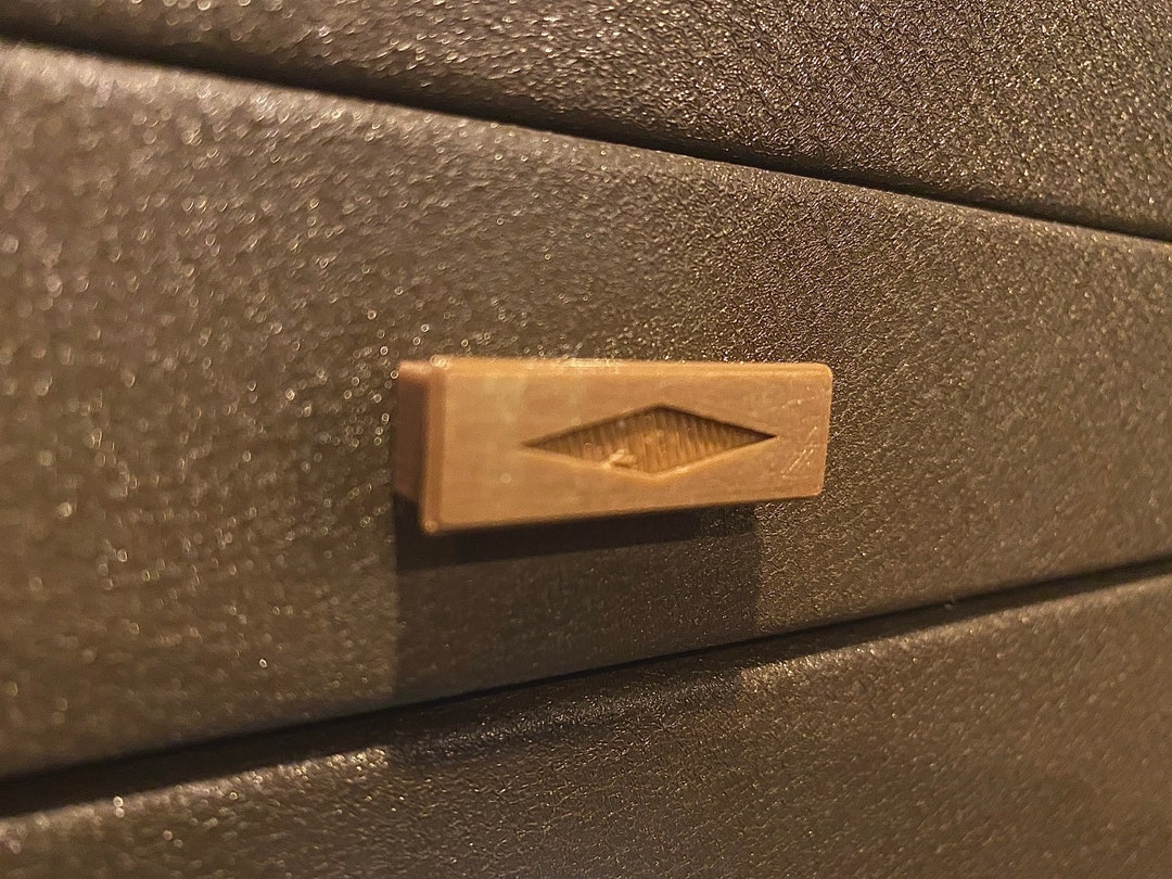

Hey everyone. I recently received my late grandfathers old tool box from his time working on planes at McDonnell Douglas. It’s in pretty rough shape and I would love to restore it as much as possible however I have been unable to find replacements for the 4 small plastic drawer pulls. Does anyone know where I can find replacement parts or any additional information on the tool box at all?
It is an ATI Industries Fabricator/Assembly ATSK 1541 Tool Kit. I’ll attach all the pictures I have. Any help is very very appreciated as this is something that means a lot to me and my family!
Side note, if anyone knows this model or has found the same model anywhere online, please let me know! I’d love more information on the tool box itself.

Those are classic Kennedy style pulls. I've seen them in black and brown. Kennedy sells the brown ones, but they're kind of expensive, at $5.61 each.
This Esty seller makes and sells sets of ten for $25, using a 3D printer.
There is one left in this eBay ad for $10, but you'll be better off buying all from one source so they match.
This video discusses making them with a 3D printer.

Neat project!
Check out my post and the responses I got in the main vintage toolbox thread here.
I started with some basic cleaners like Lysol wipes and some degreaser with paper towels. I think Evaporust is a good idea. I used Krud Kutter for rust because I had some on hand and it did a decent job. As a near final step I used 0000 steel wool with more Krud Kutter on the top where I had the most rust.
The recommendation of Meguiars Cleaner Wax was one of the best tips.
Here are before and after pics. I ended up removing these stickers. I thought at first they were authentic, and maybe had some cool history I was going to preserve, but then figured maybe not.
