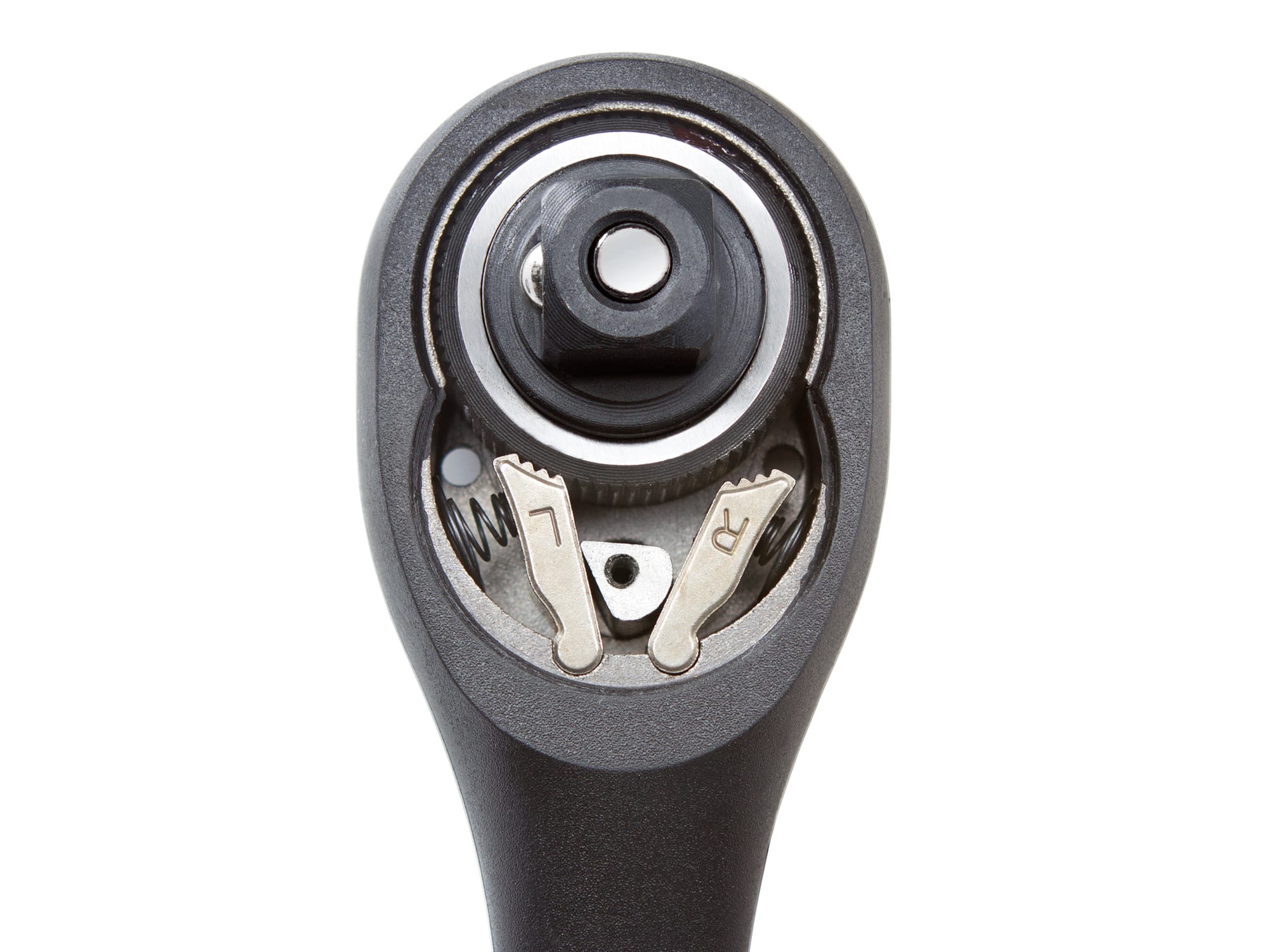

I'd say it's pretty much guaranteed a cheaper dual drive with comfort handle after seeing some examples. Everything would match up. Issue is there's probably a dozen different ones with minor cosmetic changes to attempt to differentiate beyond the names on them that it's nearly impossible to ID them without the grip. Most likely tekton with the L/R on the pawl assembly or at least the same actual mfg.

Unfortunately, what you have is a current style tekton ratchet with the rybber grip worn off. This is a pic from theyre site. Not exact ratchet, but same style.
I think the performance tool one matches better, but thats it. I have one here somewhere too.
The internals do look very similar although the housing is different and the L/R are reversed. The stamped selector switch does look like a match for current Tekton stuff, good catch on that. Although Titan, Crescent, Clarke, etc. seem to use the same bit.
It's been sitting a minimum of 10 years and probably used for a while before that to get so worn. With the composite handle theory I guess it could be an older (but not vintage) generic brand?
My newish Bahco stuff and even old push button SK ratchet use snap rings and I figured with the threaded fasteners and level of wear on this one it was older than it might actually be.
Thank you for your help, should I move this out of the vintage tools forum?
