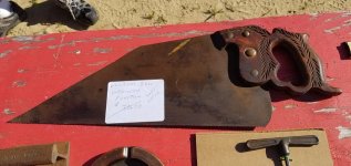

30,983
Snapped this shot for you at my Friday early bird, LS!
The sticker reads, "UNUSUAL SAW UNKNOWN FUNCTION $30.00 (crossed-out) MAKE OFFER"
EDIT: I didn't (make an offer) because the guy pissed me off. He had twelve (12) Snap/on pieces that he insisted on selling only together as a lot for $60 firm even though it was a mix of drive sizes and era. 5 bucks a piece for Snap/on is a very nice price, but I didn't need/want most of it, and literally nothing matched except the six (6) "G" (1945) code Ferret swivels sockets that I wanted!

I wouldn’t have made an offer on it, either, because $1 would probably be taken as an insult. Maybe $3 as a curiosity.
Looks like it started life as a Disston No12, in the 1896-1917 era, but now the only value, other than as a record of a thrift-minded owner’s idea of how to get a little more use out of a buggered rip saw, is in the sawnuts. The original medallion has been replaced with a regular sawnut, and the top horn is sheered off. The handle won’t fit any other saw plate (though it might not take a lot of modifaction to make it fit).
My guess is, it could be used to cut a rectangular hole right up to an obstruction like a wall with a relatively small bore to start the cut (sort of a big jab saw). That design of handle with the extra D-shaped relief for a second hand also allows it to be flipped around to saw away from the carpenter. Maybe could cut tenons in timber framing. If the acute angle of the toe is significant, it might offer a clue.

Picked up a rare treat today for $3: a 26” Disston No.112 rip saw w/6tpi. Based on production years and the medalion, 1903-1917, so a real century saw. At some point before it got much use, someone slathered it in what looks like linseed oil, which has helped protect the etch. But then someone has tried to use it, which exposed the teeth to oxidation and pitting. The handle looks great. I plan to clean up the blade and decide whether to refinish the handle or not. It’s a tough call, because despite finish loss and blade oxidation, this fairly rare saw is in as close to unused condition as any I have. Doing more than rust removal (and even that) obscures detail that tells the story of how it was made.
I can see that the shellac is at least twice as thick on the edges and hand hole as on the flats. That and the parallel machine marks on the flats tell me the edges were lacquered, then the flats sanded (or otherwise machined), and a final coat of shellac applied. Then the holes were bored and the slot cut.
Even the medalion tells a story - there is a flat edge that made its impression into the wood when it was tightened. It tells me three things: quality control did not reject this medalion, even on a premium saw; the subtle impression of the backsides of the saw nuts mean they were inserted with some force; and it did not matter that the branding on medalion was upside-down. With most of my saws, if I take them apart, I usually replace the medalion about 180° from how this one was.
