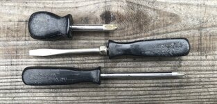

Working from ladders, as I often do, I HATE round handles!
But I do like me some nice woodies... just not round.
Proto, bottom, has excellent non-rolling handles:
Round handles were easier to make in the lathe, but I put a flat spot on one side of them as an anti rolling feature. I don't work up ladders much, but I hate getting stabbed in the foot when round handles roll off a bench.. Those Proto ones are nice but unknown in the UK.
