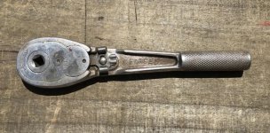

This fit the bill? I'm just over in Watsonville
1/2" female drive, flip to reverse.

31,054
The issue I'm having is that whatever I can find online on eBay or whatever doesn't have any date codes, and I have had a hard time researching anything about date-coding vintage Husky/New Britain stuff. What specific models should I be looking for?
They're not common, but they are out there, on NB, None Better, Craftsman BE and (H), and Husky reversible and non-reversible ratchets, starting in 1943 and ending in 1946, based on a fairly sizable survey I conducted a few years ago. Link to table of results here and scroll up from that post in that thread to see examples. Ole Slewfoot's is one of the ratchets in the survey.
