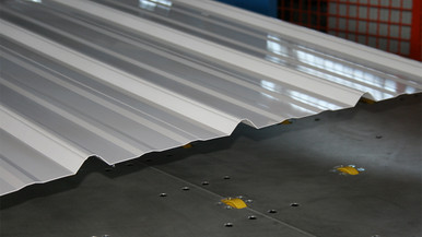

Bite the bullet and do white steel.
When it’s up, it’s done, so it’s a one time expense.
I have thin osb in the parking section of my garage, but steel in the working area and in my separate shop building. I would never do osb again.

I've done white metal and it's a one and done. More expensive but easy to hang with a drywall lift.
From what I have learned over the years, the next ceiling will have fiberglass in the bottom chords, 3/4-1" foam on the bottom of the trusses and then covered with white metal.

Liner panel or R-panel "seconds" from your local metal panel supplier/manufacturer will be far less expensive than the crazy box store prices.

I don't even consider big box stores for stuff like this. I'll check with a local manufacturer, but prices have gone up- way up in the last couple years. Money is what it is. Now that I'm retired, I have no way to make much more money, so when it's gone, it's gone. When I bought my used Miata a few years ago, my BIL asked me, dead serious, "Why didn't you buy a Porsche?"
I found a place in GA advertising liner panel for $1.85 a running foot, which is about the cheapest I've found lately. Oddly enough, the used stuff off some old chicken coop has apparently become quite valuable, as people on CL are asking stupid money for it.
