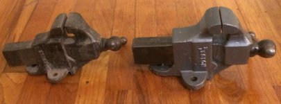

I picked up some vises last weekend. Here's some information to add to your spreadsheet:
1st Picture:
Bison
COO: Poland.
DOM: 1982.
Model: 63.
Weight: 11#.
Jaw width: 2-1/2"
Jaw opening (at beginning of nut thread) 1-3/4".
Jaw depth: 1-13/16"
Anvil: Y
Pipe jaw: N
Replacement jaw faces: Y
Base: Swivel.
Overall height/width/length: 5-1/4" x 6-1/2" x 9-1/2".
Second picture:
Taskmaster 4.
I saw that you had one listed in your spread sheet. Here are a couple of specs to complete that listing:
Weight: 36#.
Jaw opening (at beginning of nut thread): 4-1/2".

akasrick
Apr 10, 2017
795
south jersey
Victor Jersey
No 741
Stanley Rule & Level Co
New <s>Briton</s> Britain Conn USA
PATD JAN 28 08
2.87lbs. missing the swivel pad, nearest full wt. 3 lbs.
2" opening
1+5/8 jaws
Brown Japanning was alligatored, removed, hard wax applied.
guess they were comfortable advertising 1+1/2" opening; 1+1/2 jaws"
