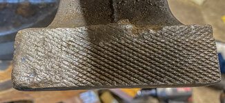

I've reworked several cast in jaws by filing the grooves. Its pain staking to say the least, but when finished makes for a nice looking set of jaws. Your other vise need not be bigger, just big enough to clamp the slide or static body. I've had best luck with small diamond files I got from McMaster, other brands have not held up well. Here is a before/after on an old Samson I did a while back.jaw after.jpgjaw.jpg

Are you sure they are cast in. I have an old parker that I thought had cast or forget in jaws. When I cleaned off the edge and looked with a magnifier it looks like they are silver soldered. I can see a thin line of shiny silvery metal between the jaw and the casting. That would make sense. A hardened jaw of the right material with the right solder, could be silver soldered in place without annealing the jaw or damaging the heat treatment on the casting. I'll know soon enough. I have to braze a crack in the slide. I'm just waiting for the nickle silver rod to arrive. When I do, I'll have to preheat part. If I wanted to avoid the coming off I'd have to be very carefully with the heat and put something on them to keep them cooler than the rest. But since I want them off,I'll give them a little more heat and see if they come off.

Yours probably has the jaws that go over the top of the vise. Mine looks like the typical kind that are flat on the back and held by screws, but there are no screws. Its not visible in the pictures but if you look with a magnifier you can see a thin layer of bright silvery colored metal between the jaw and the casting.

I think you can see it here. I polished it with 1200 grit sandpaper.
