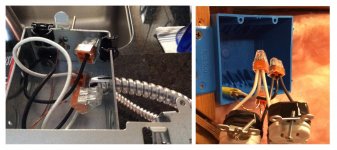

When I bought recessed lights for my garage I found the Wago connectors were included (pic on left). I had never seen nor heard of them and posted a wtf? on GJ. Others enlightened me. I researched them and ended up buying boxes of various sizes. I used them throughout my garage remodel and found them infinitely easier to use and pack into the box than wire nuts. That may not be the case for someone who does wiring often enough to be proficient at it, but that is not me. They hold fast and strong.
