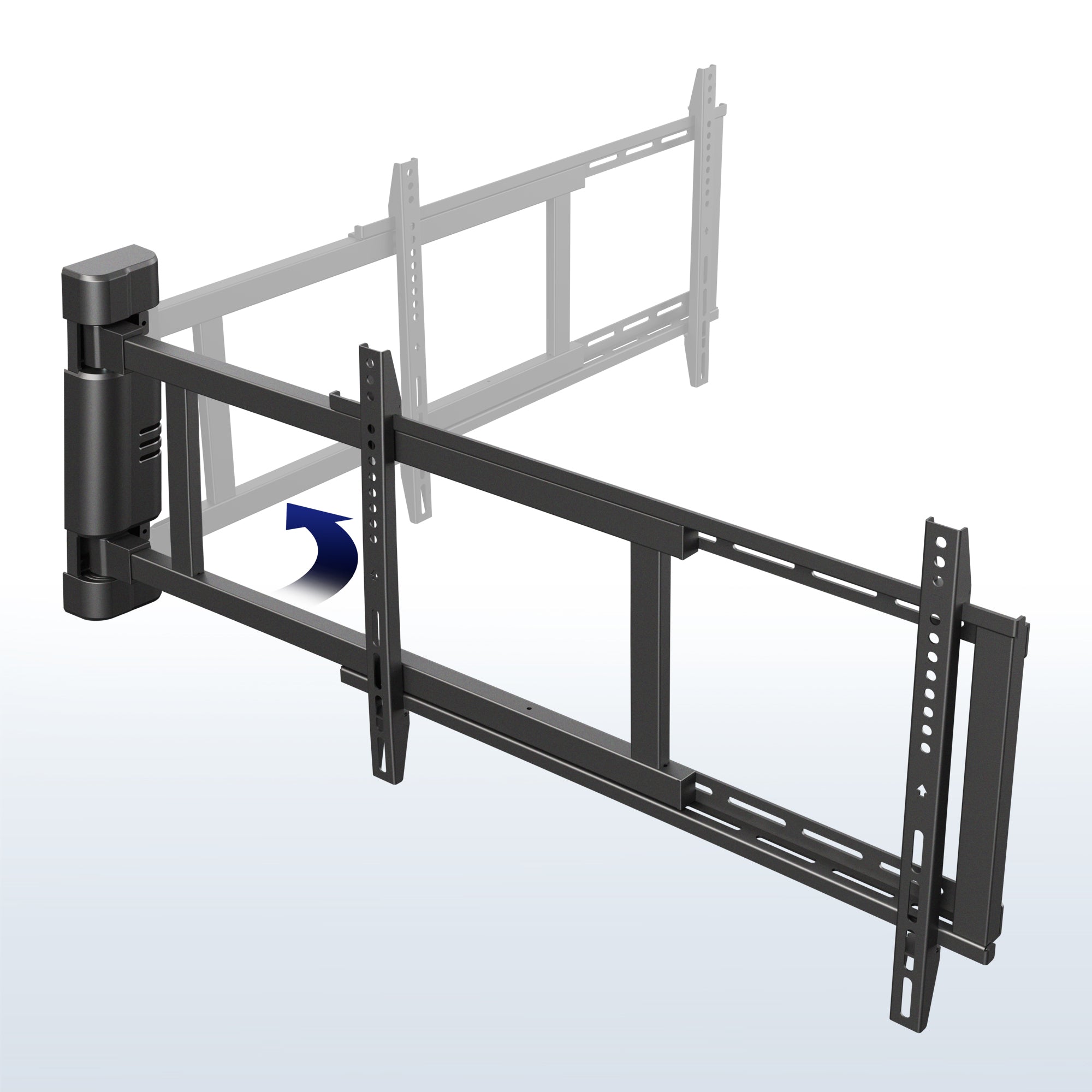

Ok guys, I am looking for some help/a sanity check. I have these 2 SnapOn cabinets and I need the floor space the lower one is in. In order to reclaim the space, in my head it seems like a good idea to mount the lower cabinet on the wall behind the upper cabinet and have the upper cabinet in front on some kind of a latching swing arm system. I am thinking I would put lesser used stuff in the rear cabinet but still have fairly easy access to it. Just unlatch the upper cabinet and swing it out of the way and I should be able to open the rear cabinet doors to at least 90* on the near side. Here is a pic of the cabinets as they are today:
I've been thinking of ways to do this that are safe and don't require welding as that isn't a skill I posses. The two things I've come up with are using a horizontal swing TV mount bolted to some sort of spacer that is then bolted to the stud. The other idea is to use something like a folding heavy duty desk bracket that would let me fold the entire cabinet upward. The upward swing idea was my first idea but as I thought more about it, it seemed like I'd need gas strut assists to help make this usable and thats when I thought about a horizontal swing. I found this mount:
The mount has a 100lb+ weight limit so I'm not worried about that, I should be well under 100lb with everything I have in there and the cabinet itself. I think this would work out great, my only concern is how to mount a spacer onto a stud so that I feel confident in how it is attached to the wall and that it won't tear right off with some seismic activity. I most def would want to have a latch on the right hand side that helps secure the entire assembly in place and not leave it free standing/held only on one side.
Am I being dumb here?
We all know the best way to get the right solution from the internet is to post the wrong one =)

Interesting idea.
I wouldn't count on that TV mount being a smooth swing for long. They're usually not fancy enough to hold up to a lot of moves.
The upper cabinet is a nice unit. Do you need to have your pullers front and center? I bet it would be tempting to load it with more commonly used tools. That would be another reason to shy away from the TV mount. Put the commonly used tools front and center.
Are all your walls completely covered with stuff already? Maybe plan out a different approach. Items like the M18 batteries would line up in a row sitting on top of the upper cabinet. I bet a couple of moves like that would open up some wall space.

I would not trust that TV mount to hold a cabinet. Plus, most people hang a TV on the wall and rarely, if ever move it.

Most of my wall space is used up. I do have another opportunity for reclaiming some space but it will involve a fair amount of effort in disposing of some old equipment that I'm not quite ready to get rid of just yet. The M18 stuff is there because that is where a gap happened to be, It will likely move eventually. I don't use the puller stuff as often as I'd like but I went through the effort of bargain hunting the plexi door case and display board for a number of years. Call it tool vanity but it is sort of the crown jewel of my tool collection and I love seeing it. Also, it feels so good grabbing the puller parts I need out of the cabinet when I do use them. I'm not a full time mechanic, its a hobby/keeps my budget in check for car repairs, so I'm sure the novelty would wear off quick if I was daily driving these things.
I don't exactly trust the TV mount to hold up long term which is why I was planning on building support on the offside for the contraption to latch against and have a second axis of support from. I also was hoping to stay at about 60-70% of the rated load capacity of that mount which might help the safety factor? Still I do worry that even the extra support, it won't be enough.
Anyone got any better ideas on how to make this happen? I'd love to be able to fit some parts drawers and/or another deep drawer tool box in that spot.

Can you move the bottom cabinet above the clear door one? Use a step stool to access the tools. The metal cabinet and tools get heavy fast, so not sure about the swinging idea.

What about going vertical?
Wire cable, pulleys, counter weight, some unistrut for guides.

100 lbs happens fast IME.
I think door hinges would work best for this. Make a frame/structure that gets firmly attached to the wall. Wouldn’t need to be much more than a post with good horizontal bracing.
I was thinking of going vertical but did not think of pulleys and a counter weight. That's a good idea. I wonder if I could just put it on a track and I could push it straight up when I need it out of the way. I think I could dodge the ladder I have above if I built it right.
I have a long ladder going horizontally above already or I would have just mounted it above and used the step ladder. Good thought though.
see if something here works for ya.
Not sure I'm seeing anything that has the kind of articulation I'd need with a weight limit anywhere near 100lbs. Maybe I missed something, if you have any specific suggestions I'd give it a second look.

I dont know what your budget is but maybe take a look at swing-away hitch adapters.
200lb + capacity and there are all kinds of bolt on stuff that would work with 2" square tube.
