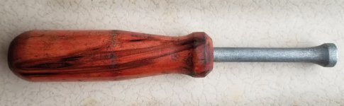

Was this carb tool perhaps made by Plomb or Proto?
Leviton
Feb 25, 2019
925
Oregon
I bought this thinking it was a cool-looking nut driver and hoping that it was manufactured by Plomb. The font on the shaft reminded me of Plomb.
I Googled the part number (T109-173) after I got home and found out it is a tool for removing/installing the main jet on Stromberg and Carter carburetors for Chryslers (and maybe other brands - not sure).
Any thoughts on if this might have been Plomb or Proto made?

Darn, I was hoping with the font, and the "-P" it might have been Plomb or Proto.
Thanks for the info, guys.
MR.X
Dec 13, 2010
1,801
That's a Carter Carburetor part number and they made most of their tools tools in-house.
Hi. Are you saying Carter manufactured most of their tools themselves? I know Blackhawk made stuff for them.....I kinda assumed we just didn't know who all their contracts were with.....Thanks.
tin medic
Oct 7, 2014
589
Fort Sam Houston, TX
Carter had contracts with several companies but they made a lot of their own stuff. I know Bonney made stuff for them as I’ve had some in the past. I didn’t know Blackhawk did, just one more to look for now. I was tracking Bonney, Kent Moore and K-D.
MR.X
Dec 13, 2010
1,801
Hi Tin Medic. I have boxes of Carter stuff with multiple other companies mixed in but no expertise whatsoever about them. I did post a single Blackhawk made Carter socket on the vintage Blackhawk thread post 1121. A couple posts later someone posted a fantastic Stromberg kit also made by Blackhawk.

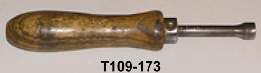

Here's another T109-173 (from Don Smith's Vintage Auto Tools web site).
It is made differently - has a metal ferrule.
