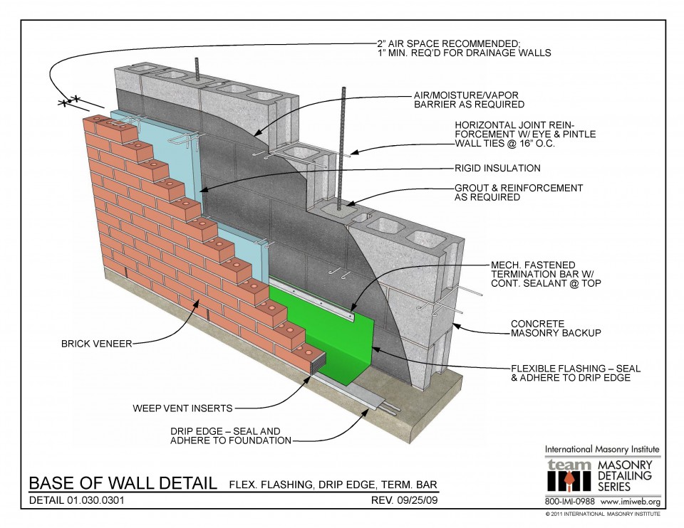

A single wythe concrete masonry unit (CMU) wall is by no means waterproof, water resistant, or water anything...
Typically you do a brick or decorative CMU veneer, insulation, air/moisture/vapor barrier, and then the CMU structural wall. Like this:
If all you have is a single wythe CMU wall then yes, you're going to get water through it.
