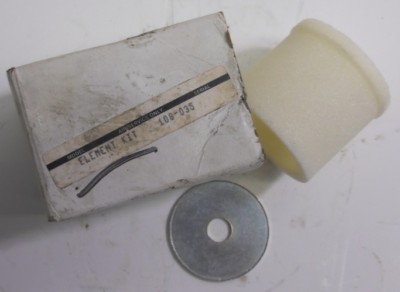

Yesterday I was taking pictures of the parts that were on my T-30 234 IR compressor. I found that the water separator (Graco 106149 I believe) was connected backwards to the tank. It's been on there for years, I can tell by the dirt and rusted connections. I bought this used. Will these things work being hooked up like that. In addition, how the heck do they work. I unscrewed the bowl and a lot of water and dirt came out. So did the assembly. Now I don't know how to put it back together. They are still available but cost around $125.00. I'd like to put it back on the correct way but first I need to reassemble it.

I tried buying a 20 micron filter using kit number 108035 but had no luck finding it anywhere.
This compressor is from 1976. You can buy the Graco assembly, but I can't find parts availble for it.

I got a response from Graco. They said the kit is no longer available. Strange! You can buy the 106149 filter yet, but they won't sell the filter kit. I don't get it.
Anyway I purchased one from E-bay.
If I need another, I guess I'll go with a different manufacture. ARO has a nice one but expensive.

If you need another filter, ask the sellers on Ebay for a measurement of the filter they are selling, many companies sell the same exact filter, or one you can cut to fit your filter.
Got it. Thanks
