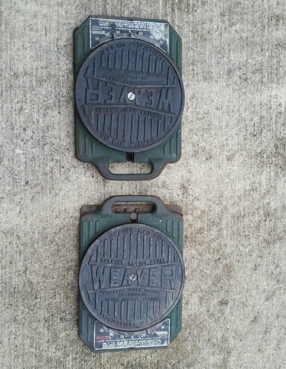

I thought you guys would get a kick out of the above... Essentially, they are 1940's era degree alignment plates made by Weaver. My buddy found them at an abandoned sign s...

Id trust those more than the fancy computer alignment gear. I can't remember the last time I had one of my vehicles and alignment shop. I cant get everything set in the shop with a tape and level. Id love a pair of those plates!!!

They're positioned under the steered wheels and measure no. of degrees steered/turned by the wheels. These alignment plates have built-in turntables. The other/rear wheels need to be raised and supported by the same thickness as the A. plates.
They're used to check 'toe-out-on-turns', steering angles left/right and when measuring castor angle etc. You also need castor/camber/kingpin inclination gauges and tracking (toe-in/toe-out) gauges to do a full wheel and suspension alignment.
All the above has now afaik been supplanted (learned a new big word, been waiting a while to use it!) by the modern computerised alignment rack with laser sights?

When I was living in Texas I worked for Overseas Motors in Ft. Worth,a British Leyland dealership. We used these to align Rolls Royce, Jaguar, MG and Triumph as well as whatever else we would get in, and this was 1978/79.

Pics of the underside / mechanics of these?
Just remembered, they also have a slider mechanism built in because you shouldn't drive up onto them and when you lower a car down on a floor jack the wheels tend to move outwards as the suspension is compressed.. the track of the front wheels also changes as the wheels are steered.
