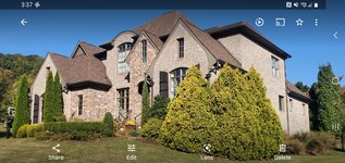

Hello all,
I am struggling with how to handle removing something called "Weeping mortar joints". Supposedly this was a "style" although I have no idea why. But when the house was built, the Mason simply left the mortar to dry instead of removing the excess coming from the joints.
I am looking for the best way (open to any ideas) to remove the excess in order to paint the house white. There is limited info I have found on how to do this. A Mason suggested an angle grinder with a diamond blade, but said the vertical joints are tricky due to the cutting wheel size compared to the joint height. I'm also not wanting to cut deep into the joints as I would prefer not to have to repoint the whole house.
I'm curious to see if anyone has ever ran into this or has any ideas of some sort of adjustable depth tool I can use to only remove the mortar slightly beyond flush.
Thanks so much

How much area do you need to work on? The job is going to be very time-consuming and fiddly. Plus, it's going to be difficult to achieve an even look on those joints, I think. That said, it is lazy, sloppy work by the original mason. Or, maybe it was done by an amateur mason who just wanted the brick done ASAP.
If it were my place, I think I'd shrug and paint the wall as it is. The uniformity of the white paint will minimize the textural crudeness, at least to some degree. If you do work on that, you're going to be at it for many hours. Wear a respirator mask and safety glasses. It's going to get messy.
On second thought, here's an idea you might want to try. On an area that isn't highly visible, try a hammer and masonry chisel on that mortar. Don't bash, but just tap away and see what the affect on the old mortar is. See if you can't chip off some of the excess and even things up a little. I think it's worth a try. If that works, a pneumatic chisel might be a good tool for the rest of the wall.

The easiest way to screw up brick and mortar joints is by using a diamond blade on an angle grinder near the bricks or mortar.
The diamond blade will slice right thru the brick.
If you need to repoint, running a diamond blade thru the center of the mortar joint and then chiseling the mortar out is the best way.
Trying to cut next to the brick with an angle grinder usually notches the brick, and future repointers will curse you.
For trimming off the mortar that hangs over the surface of the brick, you can probably just hammer a wide brick chisel over the surface similar to the way you use a chisel to trim a wood dowel.
It won’t make the mortar ultra smooth, but it will knock the raised mortar off.
A toothed stone chisel will likely be easier to use.

Unfortunately (sounds odd) it's a large 2 story house with the brick all the way around. We spoke to a custom home builder who had done just that, and painter over a weeping mortar house. From a distance it looked nice, but as you got closer the shadows from the weeping mortar made the exterior look clunky and actually drew focus to the mortar joints.
If it were up to me, I'd just leave it and be happy. BUT the wife isn't a fan... so here I am looking for the best way to waste my time making her happy ;-)

Thanks for the reply. The Mason later sent me this tool: and was wondering if anyone knew of something similar with an adjustable depth.
That "finger" is garbage. After building a jig to drive it in straight lines (it'll pull your hand all over), and control it's depth, you'd be able to cut around maybe 10 bricks before the diamonds are gone. In bits alone, it would be cheaper to bring in a wrecking ball and start over.
I do own a finger like that, but mine is cross drilled for internal water cooling. I used it to cut some curves into tile, but it isn't really made for much more than that. Re-pointing a house with it is just laughable.
neophyte
Apr 23, 2012
9,555
Pennsylvannia
Thanks for the reply. The Mason later sent me this tool: and was wondering if anyone knew of something similar with an adjustable depth.Screenshot_20221118-133516_Chrome.jpg
You would really need to make an router or trimmer type attachment for that,
WITH DUST COLLECTION.
Flex used to make a tool that used something similar, with a dust port, but it has likely been discontinued for a decade, and I doubt it was widely sold in the USA.
Checking if the diamond point can handle trimmer sized touter speed, and look into modifying a router/trimmer base would be the best option for that.

Try this on a small section to see if it gets an acceptable look.:
Take a sharp chisel and knock off the protruding mortar. An air chisel or demo hammer will make quick work of it.
Spread tarps on the ground to catch the debris and then drag it to the trash.
Tuckpoint as needed. It'll be flat at best, and not concave.
If it's still ugly you could do a combo of Hardie plank siding, PVC trim, and stone veneer to update the entire look of the house.

Thanks for the reply and suggestions. Our neighborhood HOA requires mostly brick siding, so we are stuck with that.

Since you're painting it all I dont think it will girt if the brick gets touched here and there. I would grab a grinder and turbo cup and start knocking down the mortar and see how that goes.
Not too bad of an idea, it would markup the bricks, just not sure how bad. With the paint it might not matter too much. Thanks for the suggestion!

To answer your question: I think the right thing to do it use an angle grinder and those tuckpointer electric tools and repoint all of the joint to desired joint style. Concave? Maybe grind level to the surface is another, less expensive option? But neither of these are DIY jobs. I can see a mason making good money on this bid. Scaffolding and all.

Sell it & move. I never understood that *style*.. what do they call it.. "We hired the cheapest brickie on the planet"? There are yard walls here like that, looks like fried ***.
As for the fix... SDS chisel, shouldn't take more than 6 months...
or how about a needle scaler? Wear good gloves or you won't be able to tie your shoes or wipe your *** at the end of the first hour.

I have zero experience with pneumatic tools, but I'm open to them. I looked up needle scaler after your suggestion and it looks interesting. I saw videos removing paint from brick. Would you think its strong enough to get the weeping mortar off?
It's certainly worth a shot, maybe try a cheap one from Horrible Fright & see how it does.
As for the SDS option: You can buy a 1/2in SDS chisel... but I have no idea how many you'd wear out on this project (altho you'd also be going through quite a few sets of needle scales with a scaler)..
However, I'd probably get a 3lb lump/club hammer & a 4in wide bolster (also known as brick chisels) & go at it by hand by hitting down/upwards instead of following the mortar line.
