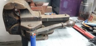

A guy is selling a weird looking vise that I never seen before. anyone have any information on it? and how it works?

I would buy that. I'm a sucker for the unusual stuff. How does that lever work?

That I think is a machinist vise. Not for use in a mill but in a machine shop. The jaws are smooth so as not to mar up the finish on a part.
It is quick acting so you put thenpiece in and slide the jaws closed. When you operate the lever it clamps the jaws just a little and locks them in place. Very much like some drill press or milling vises

thanks for posting it up and I'm not sure if it's the maker that has been mentioned cause there were a couple makers of this style, but it is old and it is unique and not very common.

To my minds eye that is a quick acting PRODUCTION vise. It would be used in a production environment where an operator is clamping the same part over and over and doing some job on it.

There are no casting marks what so ever on the vise. I will be putting it up on the vintage vises soon after I clean it up a bit.
I've used it a bit today and I can see it being one of my favorite tools in the shop. Its very fast and holds just about anything really tight.

That's a great old vise. I would happily pay a good deal more than $40 to have a nice example like that.
