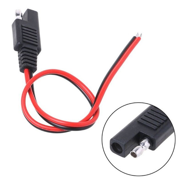

That did finish up nicely. Those Gas struts do not make it easy to work out if you have the correct unit. Now I also have to ask what is the plug in the middle of the picture?
Hello Simon and thanks for stopping by.
That plug in the middle is my battery tender. The battery is in a hatch just below the lid that the socket is plugged into.
Better picture of that here
:beer:
F
Finallygotit
Jul 6, 2013
4,109
Tucson, AZ
Now Dan that is a clever way to connect it.
Mine have a fitting like this >
or I use the alligator clips with jumper posts like this >
Thanks Simon! I wanted something that was easily plugged in while not protruding into the trunk and not dangling on some wire.
Those connectors you are using will definitely do the job, especially the post type.
Thanks for stopping by.
:beer:
