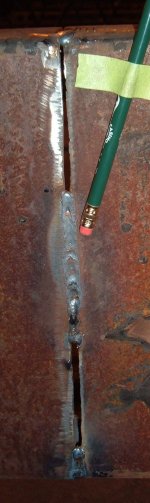

You won't regret a 220V machine...they are so much smoother.
They will draw 2x the power from a circuit that is 2x the voltage and usually has a better wire. The technology is the same.
Pic 4 is a variable V machine, stopped and tuned a volt to try to get the spatter down. 3 is a Hob 210, could turn it up far enough to get it to flow without ripples. 2 is a 10Ga plate, vertical, could fill it in a pass.

Sure enough, I checked out CL local to you and there isn't much at all. I looked from Little Rock to Shreveport. A 211 for $1700...lol. If you come down to Florida there are always machines for sale. Wonder why the offerings in your area are so sparse?
Yeah, believe it, it's bad around here. I bought and sold stuff all day long when I lived in Little Rock, but come south of there and it's dried up. I think a lot of people use Facebook classifieds around here which I don't really care for. I'll keep an eye out either way though.
Thanks for the pictures!
