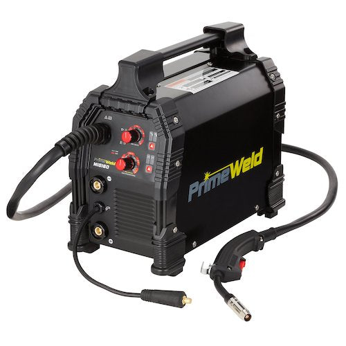

I do not have a PrimeWeld MIG welder, but I bought their TIG and it has been super! They feature a 3 year warranty, 7 days a week support, and well written manuals. I have no affiliation with PrimeWeld, and I’m not getting paid to say it but they are well built machines. They’re made overseas, but the company must have a quality control program in place. My TIG225X has been flawless.
I agree that the big names are quality units, but I can’t shell out that kind of money for occasional use. Otherwise, I’d have went with a Miller for the TIG. I think paying a little more gives the backing of a company that will honor the return of a defective unit. I appreciate the support of a real company behind the equipment.
I’d consider shopping around a bit. I’d also consider going to a MIG with gas. Flux core is ok, but the shielding gas really ups the ante IMHO. If you go with a more reputable company that has a presence here, it’ll be easier to get it covered under warranty if there is an issue.
‘PrimeWeld
