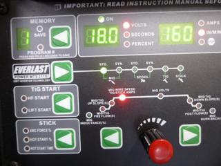

xman_charl
May 16, 2017
194
bought this everlast multiprocess several years ago..
works okay
Charl
