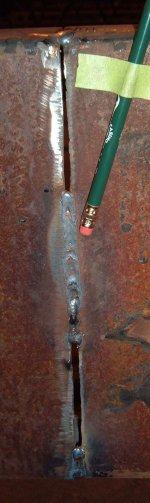

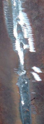

sberry
Jun 18, 2005
35,747
Brethren, Michigan
This is a Hobart 210. We set the first bead with the chart as most people may do, it was cold. As of the second we could wring every drop out of it but could turn it up with a little warming to take the ripple right pout of the bead and we didn't clean the plate.
The4 pics were a cut and slash job where we kept the job dimensionally accurate and simply filled the gap with weld. Got it close fitting, The steel about 10 gage and can roll right down it hanging puddle surface tension and fill this in a simple pass, no cold weld, no extra when it was done but the web in that joint being 1 piece again and way better than it needed to be as a connection.
