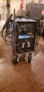

Nothing fancy and doesn't really help with any ideas, but the cart I made for my arc welder. Picture was from when I was still making it. I did tie the up rights together to form a pull handle.
