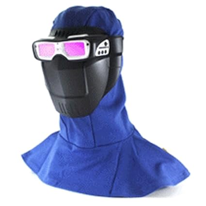

I bought these Servore welding goggles a few months ago. They are the greatest thing for the MIG welding I do. If doing close up fine work and/or are near-sighted, they are so much better than a conventional hood with auto-darkening lens. I think Miller now makes a similar one now. The Servore mask, hood + goggles are $219 on Amazon.
Kinda scary looking and would be useful at Halloween when answering your door, lol.
