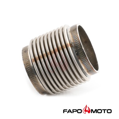

Doing some thinking and with the shape and size of the pipe, purging is not likely going to happen.
Would doing the Solar Flux trick help?
If it goes together as I expect the existing exhaust pipe should slide into the machined end of the new Bellows so it will not be a "****" joint.
This is the bellows I purchased.

you might not need those solar flux, it's nothing but back purge or flux to protect the back side of the stainless metal where shielding gas/gases could not, that is only when you get the stainless heated way up to that critical temp when it started to "sugaring" oxidation and lose its characteristic... lots of people choose not to do it as well on their fixes, I think that subject have been beaten to death... you should be fine if you don't over heat it. Just a suggestion since you mention "stainless welds" It's something you should be aware of.
