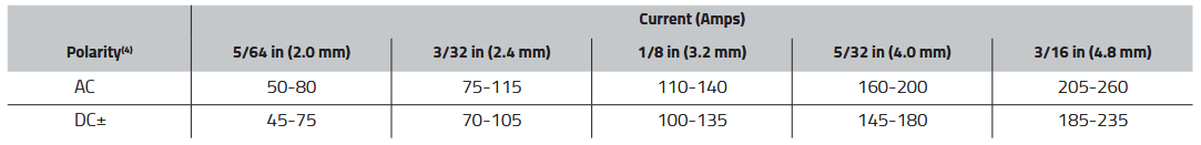

For this machine, the polarity type of current to be used is a big factor. The AC/DC 225 is rated 20% duty cycle at 225 amps/25 volts for AC, and 20% duty cycle at 125 amps/25 volts for DC. Using 1/8" E6013 rods the recommended amps are 110-140 on AC or 100-135 on DC. So if you run these rods on AC the amp range will allow the duty cycle to be much higher than 20%. If you run these rods on DC, the amp range is close to the maximum rating for DC and should not exceed 20% to protect the machine.
