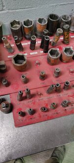

For our socket boards at work we just mig on the appropriate size square stock. I don't have any pictures handy but I'll take some on Monday.
Personally unless I had an ironworker or punch I wouldn't spend putting holes in the plate.
speed bump
May 28, 2008
6,317
Butte Montana
Here's what we have at work. Just make sure your posts are welded on opposite sides of the sockets or they will be tippy. Not a perfect solution but it's quick and holds sockets.
