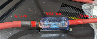

So, I'm driving a set of DC to AC inverters with a set of Lithium batteries. I have two places to view amperage and they both "agree" within about 10%. I'm pushing 165A continuous (55A * 3 batteries), my cables (both) are getting "warm" to the touch, not hot, I can keep my hands on them, and seem to hold temp for the hour or so I ran this test. Cables are hand pressure crimped with copper, 3/8 terminals, they are not hot at the connectors.
I don't typically like to see/feel "warm" wires. Thoughts?

The definition for ampacity is the continuous current that can flow in a conductor with respect to rated ambient and temperature rise so I suspect the chart is for continuous current.
I don't know what the Universal chart is telling us. I would disregard
The welding cable chart looks in line with what I used in the lab for long term experiments
If the cable is marked 90 degC , the rating is usually 55 degC rise over a 20 degC ambient for a total of 75 degC total temp
If you are running 165a , assuming the rating from the chart is 550a continuous, temp rise = (165/550)^2 x 55 = 5 degC +20 degC = 25 degC
Maybe even up to 30 degC total
So, I would say warm , not HOT.
Have an infrared heat gun to check ?
You have lots of margin in this setup.
How did you hand crimp ? Hydraulic tool , crimping tool , hammer punch crimper ?
Any of these will work if properly used.
In conclusion. You are good. Don't worry.

Yes, I have an IR temp gauge. I just tore this down off the "bench", so it'll be a bit before I can re-test it. I'd say 85-90F, "warm" to the touch. Easy to keep your hand on it. I ran it for an hour.
I'm largely asking because I may need to push this up to 225A @ 50V DC (we'll use 4/0 wire everywhere).
Hammer punch crimper.

If it's hot at the crimp only then you have a bad crimp.
Otherwise I would not use no-name brand wire in an application like this.
