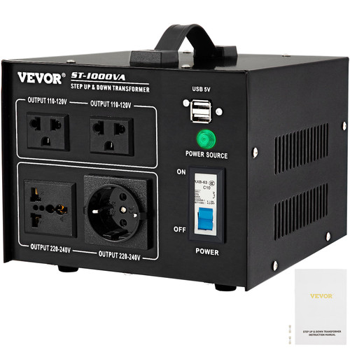

I will be moving to England soon. Moving all my tools and furniture is payed for me. I plan on taking my Hobart 140 that runs on 110v. I'm being told there are little-to-no 110 outlets in England. Has anyone ran a 110 welder on a voltage step down? Is it possible? If it's not ill keep the welder and buy a 220 unit but I thought I'd ask

No experience running a 110V welder, but have run a bunch of 110V 60hz things on 220V 50hz. First, is it compatible with 50hz power? It's my experience that most modern electronics sold for 60hz use will tolerate 50hz electricity. Looking at specs for the 140, it draws 20amps / 2.9KVA. It didn't say about 50hz compatibility. It's gonna take a big step down transformer. With a low duty cycle, you might get away with something rated less than 2.9KVA by putting in a higher rated fuse, but it would be trial and error and there's a high likelihood of frying an expensive step down transformer.
I'd probably look for a small welding machine in the UK.

My first MIG was a miller mm211 transformer machine - specs called for 60hz ONLY, either 120 or 240 volt.
Second one was also a miller MM252 - ALSO transformer, ALSO 60 hZ ONLY.
Third one was the newer MM211, inverter model - 50 OR 60 hZ 120 or 240, doesn't care.
I only spent a few months in England teaching soldiers top secret military equipment - this was back in the '60's, and I don't recall how things were wired in houses, other than all the light switches being upside down - it may be possible to get a step-down transformer, but would probably be a LOT less hassle to sell the Hobart and get one of the more popular euro welders there.
Even if you could find the right voltage transformer, you'd still have the frequency problem, and I doubt that a small older (likely transformer) welder would like the different frequency anyway... Steve

I can't come up with a scenario where it would make sense to tote that machine with you if you plan on welding over there. It may be time to upgrade to something like a Miller 211 that accepts all the power inputs and frequencies you could come up with between UK/EU and the US.

Not only is the voltage different, your cycles per second (Hz) is different... IF you have a logic board that is designed for US only, it will put up the square smoke ring of death. I left my awesome 211 Miller miracle box because of this, I also know housewives who have hobart mixers that they tried a regular transformer (didn't change the Hz) and blew them out PDQ...
I have a (pretty godawful expensive) device called a Voltage Exchanger (somewhere in the neighborhood of a few grand) that works just up to 15 amps. It converts 230V50Hz to 120V60Hz - I have 2 or 3 higher dollar things that require US current.

In the UK on industrial companies ( ie builders) it is required to operate mains powered hand tools over a 220/110 V isolation transformer. Heavy, usually 3 kW and housed in a VERY sturdy box, yellow. I guess the are quite affordable second hand. Could that be of help?

53 years ago we lived in Frankfurt Germany (dad was army and stationed there).
We had small step down transformers about the size of a small piece of carry on luggage. Metal box quite heavy. 230V50hz was stepped down to 110-120V 50 hz so we could run some American appliances.

They make all kinds of step downs like what you are looking for.
