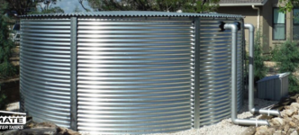

Do they make "bladder types" that store thousands of gallons?
I've got a few bladder types for the RV, I throw them in the back of the truck, but we're talking 80 gallons or so.
The only bladder type I know about are the "steel tanks" you see in Texas. They're just steel bolted together with a liner. A bit like an "above ground" pool. I liked these, but they were a lot more expensive than the plastic tanks that I put in due to the assembly.
We have one of these (40K gallons) at our firehouse for a rainwater collection system. It’s been fine for ten years but the bladder is incredibly thin. I’ve come to prefer poly tanks, and I have one at my windmill well.
I think you're confusing this 300-gal-bladder-tank-lg-2.jpg with this download.jpg. The folks in this thread are generally referring to the latter when they mention bladder tanks.
There are bladder tanks like the first one available in sizes holding many thousands of gallons. The military uses them to provide water in temporary situations.
