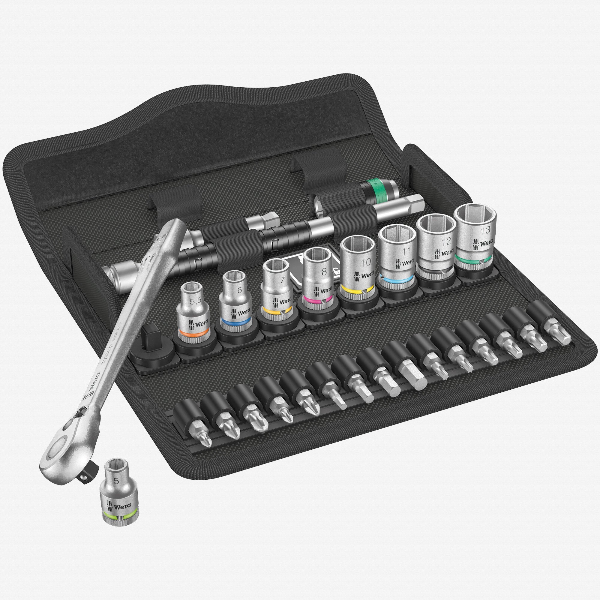

I didn't see a thread on this yet, so I wanted to ask... How many of you have the Wera Tool-Check Plus? Do you find it useful and actually use it? Do any of you use it at all for automotive work and what kind of work? Do you have any complaints (bit quality for example)?
I've been wanting to get one for awhile but wanted to see what GJ thinks about it before I drop $80.

I'm glad to see that kit includes a 12mm socket and does not include an 11mm; for some stupid Euro-trash reason, Wera skips 12mm in some of their kits yet tosses in an 11mm which has no earthly use unless you run into a 7/16" nut somewhere.
And to be super-specific, Wera's Hex-Plus hex tools are legitimately amazing, next-level torque capability. All their bits are great quality as well.
A few specific beefs with this kit. Much of this is personal taste and experience, of course.
- No T27 bit. WHYYYYYYYY why why would you leave this out, especially in a Euro kit?
- No torx smaller than T10. May or may not be an issue in your world, of course. I'd at least toss in a T8.
- You could make some room by removing some of the smaller torx bits that overlap with security torx; with T20 and smaller, security torx is plenty strong.
- No P0 bit. YMMV, of course.
- No 7 or 9mm hex bits. Uncommon, but I have encountered them and I would want them available.
- The PZ stuff is useless in my world. Maybe not in yours.
- A 14mm socket would be awfully nice, but there's no place to put it. I can't recall ever using a 5.5, though...
- There's only one slotted bit. One or two smaller slotted bits might prove useful
Personally, I would remove the PZ **** I'll never need, possibly remove the overlapping torx/security torx bits (T10, T15, T20), and buy some individual bits to fill the gaps.
And I really hate buying from scAmazon, when the kit and all the individual bits you'll want are so easily available from a great supplier like KC Tool. Slightly higher price, but it would be a lot more convenient to get everything in one go if you want to customize your kit:

I don’t have the Wera Tool Check Plus. I might acquire one at some point, as I think they’re a good option for a road box.
Perhaps I can clear up some misconceptions.
Wera may be a German company, but they don’t make tools in Germany, and haven’t done so for the best part of 30 years.
Their screwdrivers, hex keys, torx keys and screwdriver bits are all made in the Czech Republic. They have been since the “Kraftform” drivers were introduced.
Wera were not, historically, a maker of wrenches or sockets. These are a relatively new line for the company, and are made in Taiwan. Again, they always have been.
Wera’s design is very good. You may not agree with everything that they do, but they try.
The Czech factory is not some “outsource to the lowest bidder” deal, but is actually Wera’s factory. The Czech’s can produce very decent stuff, and the Czech Wera is excellent in my opinion. The steel is good, manufacture likewise, and quality control excellent.
I have a lot of hex keys and screwdriver bits, and consider the former second only to PB Swiss. Wera offer a greater variety.
The Zyklop ratchet’s are made in the Czech republic, but all sockets, extensions and mini ratchets are made in Taiwan. There is still some “so so” stuff coming out of Taiwan, but Wera isn’t it. It’s up there with the best of Taiwanese, such as Facom, but differs in design and finish.
It’s good and durable. This 13mm socket has seen a good deal of use and there’s no real wear.67806DE8-1C0B-439E-8C8A-EEA2B8EE86A0.jpeg
I reckon the best tools Wera produce are their hex and torx sockets. The socket bodies are made in Taiwan, the blades in the Czech Republic and they are superb. These 1/4’ drive long bits are my newest.CAD0A12C-F06F-44BA-AC9B-526120FF5BCB.jpeg
Bear in mind though, that in the U.K. and Europe, Wera tools are “mid price”. If you’re shipping them a long way and paying top dollar, there may be other options that represent better value.
Edit - both DIN and ISO standard bolts use hex sizes of 5.5, 7, 8, 10, and 13 for bolts of 3, 4, 5, 6 and 8mm. 11 is the standard size for 7mm bolts. This is uncommon, but that’s why it was included in some sets. 12mm is a JIS size, but probably more common than 11mm.

I have that kit. The bits are great (especially the gold diamond coated). That mini bit ratchet is indispensable (though has higher back drag so I cut a coil off the spring and lubed now it’s perfect).
The sockets, while well labelled, tight fitting (<0.005” to size) and nicely knurled, they have a very heavy lead in chamfer reducing contact with the fastener, and they’re much thicker than a standard chrome as per comparison below. For rusty or hard to access bolts/nuts they are not the first choice, but a solid road kit for a bike.

One observation about these sets, is that the ratchet included is a bit ratchet, not a regular ratchet.
To be honest, these are becoming more and more essential. I seem to find fasteners on a weekly basis that can’t be accessed without one, or are much easier with one.
The downside is that it’s optimum for the bits, but you have to use the adaptor to utilise the regular sockets, which adds to the overall thickness.
It doesn’t seem to be one of Wera’s better known items, but they do offer a mini ratchet to match the mini bit driver. My “go to” box of 1/4” drive is a real mix of different makes, but I include both these Wera tools47D6E4CD-7B64-4716-87D4-B642FDD36934.jpegB799B0C4-37EB-4D90-A895-1996959FEB88.jpeg

I wanted to get the metric set for several years and finally decided to do so after seeing that Wera came out with a ratcheting T-handle that I had to have. Been looking at various ratcheting T-handle bit type drivers for years and have had several that were OK. Think they recently introduced the ratcheting model and I wasted no time ordering one along with the metric bit/driver set. My first tools from Wera and a bit pricey, but the quality/function/form is absolute top notch and I have had some quite good tools over the decades to make fair comparisons.
On a side note, I ordered these from Chad's Toolbox, which was a first for me as I never even knew the company existed. Had exactly what I was looking for at very fair prices, free shipping, no tax and was very responsive to the few messages I sent. No doubt will order from him as needed. Not affiliated in any way, just posting my super positive buying experience after having read quite a few negatives.

I love my tool check plus. All my other bit ratchets and offset screw drivers are obsolete now. Pretty rugged, too. I bought a longer handle flex head bit ratchet from VIM for other hard to reach places.
My only qualm is that the sockets are not really super useful. With the 1/4" drive bit, it's a pretty chunky package. I do wish there was a T27 bit in it, but it's a weird size.
Otherwise, the Tool check plus is very handy for interior work.
