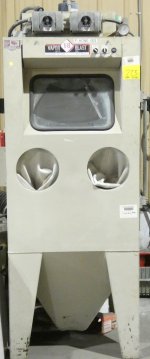

So I have been looking at one of these machines for a few years and now I have decided that I need to own one.... Seems like they are a great metal refinish machine. The only problem with them is the cost of a true quality machine! A medium sized machine seem to be $10k and up!
So in my normal mode I guess I'm going to make one...That.and given the fact that I under bid one at the local surplus sale about 9 years ago. It was a nice unit all stainless steel from an aerospace company ( over $20k at the time) I don't like the sealed bid format:) As I now have the means to build one, I have started to design one.
1st design question; $tainless or just use the more economical cold rolled sheet? Looks like I can get 304 12 gauge 5X10' sheets for about $900 each (ouch!!!) I have 4 sheets of 12 gauge 4x8 that I picked up years ago to replace the belly box floors in my moving van. I painted them with dp40 and catalyzed enamel, I can use for "Free" as I'm not replacing the floor. The down side is that I'm not sure how well the paint will hold up to cutting and bending the sheets?? I can always touch up the cuts lines and bends if they cause paint failure. Also the current design it set for the 5x10 sheets so more cutting and some more waste with the 4X8 sheets.
I know the SS will last forever but I don't have forever left, probably 20+ years of blasting left in me and I'm thinking that the mild steel will last that long??

Stainless to prevent rust while not in use would be my choice but I would likely use 18 gage ss at .050. Stainless is fairly stiff material especially when bent. 12 gage seems unnecessary And more expensive. There should be no ballooning air pressure when a cabinet is properly pressure balanced by the correct amount of ambient venting. It becomes basically a cabinet that should not leak.

Use the 'free' carbon steel, stainless is not needed. And 12ga is way overkill IMO

The design choice of 12 gauge comes from the class of cabinets I'm looking to copy. The one I bid on is the model I really want to own/copy and it has 12 gauge upper and 10 gauge lower in the sump.
The material thickness is not really for strength but rather for abrasion resistance. My bead blast cab is also made out of 12 gauge material ( it's a copy of a tip model 1250?? that they used to make!) I looked at the catalog for many hours to figure out how they made them 35 years ago, and funny story... I was welding it together at the community collage (welding seminar) and one day an instructor from the autobody section walked through the welding shop and said... come check this out, walked over to his area and there was a brand new TIP cab sitting there! I could not see in the inside of the cab from the catalog pictures, and it turned out that mine is made better than the original.

So here are a few examples of the cabinets I'm looking at
The one from above is the actual machine I bid on the winner of the sealed bid shipped it to PA from Iowa and then sold it later for $5k!
As you can see it's machine F-003 I have been hopping that machines f-001 and f-002 would be sold off 2, but so far no go....
The company has since closed down or got adsorbed into Vapor Hone Technologies after the founder passed away. They are going to be selling them again.
tp.gifVideo of the 60X36
I'm thinking about a 60X36 machine
I'm also looking at a Clemco Wetblast machine for "ideas"
