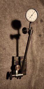

I can’t find any markings on them from a manufacturer or model number or anything else.
I rescued these two items from somebody’s damp storage. I brushed off the cobwebs and loose rust and sprayed on some WD-40. I assume they are tools to provide a reference point on a 3 dimensional object. The larger one has a double ended pointer that swivels. The big supporting arm rod has a coarse and fine adjustment screw.
If they have value, I will post them in the classifieds. Thanks!
A2B0244B-86C6-46A8-B0C2-45C80069D8E0.jpegF250DC94-1453-4ED6-B050-3AA4BC27EDDF.jpegDE52EF13-F93B-46D8-A43F-148A6CF2034B.jpeg

I believe they are called a surface gage.
The one on the left is missing the scribe which would make it less valuable IMO.
I don’t know how much value try would have because most of their function is covered by dial or digital height gages which now are surprisingly affordable.
I haven’t used a surface gage since the late 70’s.
They can still do things that a height gage can not.
For example. Set the ball of the arm up on the bottom and install an indicator 6" up. Place the ball against the side of a good known square setting on a surface plate.
Adjust the indicator to read zero also against the square just 6" up from the plate. Now you can take the surface gage and set against a part at an angle so the ball is touching and pivot it around and see how far out of square its machined by the measurement on the indicator.
We measured machine ways for perpendicularity when we were scrapping them in.

I find a surface gauge very helpful for layout on occasion, as you can easily and accurately scribe a line on, around, or inside something that may otherwise be hard to accomplish. The dial indicator is also useful on it, but that can't scribe. I wouldn't be without one in a fab shop.
