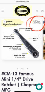

Davefr
Jan 7, 2010
11,944
OR
One more at .587” wide 👍 And, made in USA. Bits may be proprietary …
Please note: Chapman ratchets are designed to be used with Chapman bits. While they may fit other 1/4" Hex drive bits or extensions, they are not guaranteed to work as a universal tool. Replacement colored ratchets of the same color cannot be guaranteed.
Those Chapmans are pretty primitive but they've saved my **** a few times when nothing else would work.
