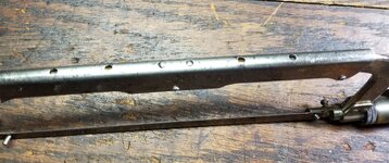

My first Keen Kutter find since summer of 2021 turned out to be a real doozy! An adjustable (8"-12") hacksaw frame. To use different blade lengths, you push those buttons at the top and slide in or out into graduated holes. The frame halves are retained by a built-in spring-steel sheath. It does not break down. Twist handle type with a rather sophisticated little spring-loaded button to pop the blade off. It's not marked with a model number, but I found it in the 1912 catalog on IA/ITCL. Model No. 188A.
29,774
WOW! that is some piece of work there.
so.... you push that little button in on the middle of the frame, and that releases the catch thingie and allows you to adjust the length of the frame? did I get that right? :unsure:
30,956
The frame is in two halves, plus the sheath where they are joined. Each half has a "button" - in actuality, it's a just a lug at the top of each half. That long spring steel piece is keeping the lugs through the holes. So you are just freeing it up to slide by pushing it through the hole. You have to back the handle off to release some tension on the blade, first, which pops off with that spring-loaded mechanism near the handle.

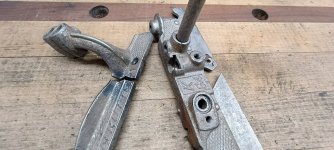

You have a broken universal bevel gauge that is missing the blade.
It should look like this:
Just got a Keen Kutter bevel gage. It is also marked with the patent date of Oct 29, 1907 which is Ernest A. King's patent # 869851. Assigned to Disston & Sons. The patent was for the addition of a ball bearing at the end of the long screw so more pressure could be applied. Mine apparently had a broken wing nut and was replaced with a knurled knob. It's actually pretty nice.
  • US869851 Bevel Gage Keen Kutter Disston.pdf
