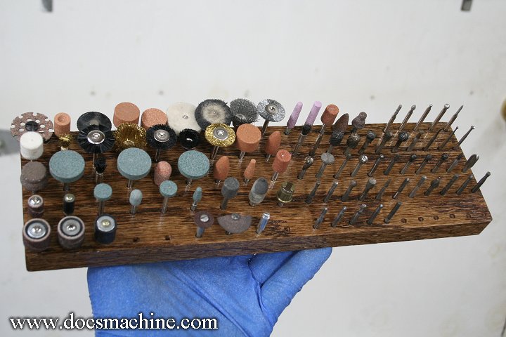

These are just the bits I keep out for easy access. :D
I have two Dremels hanging from the pegboard on my main workbench, and two or three others that I've worn completely out in a drawer somewhere.
Recent uses? Broken head bolt in an Olds V8. Used the cut-off wheel to grind a slot in the top of the stub, turned it out with a screwdriver. Used the fine sanding drums to slightly relieve the top of a Ruger #1 breech block, so it could pass a larger-bodied cartridge. Slotting stripped allen-head screws so they can be removed with a flat screwdriver. Used the wire brush wheel to clean the contacts in an old GM headlight switch. Notched some headlight buckets to take some aftermarket driving lights. Shortened machine screws with the cut-off, then deburred the cut end with a stone.
I use the long pink chainsaw bits to grind the flutes of taps to resharpen them. I've reground broken drill bits into custom-shape endmills. Once, I ground cutting teeth into the head of a 10-32 countersunk screw, to use it AS a countersink. I've used the various stones to sharpen actual countersinks, endmills, drill bits, saw blades and boring bars.
I've used a diamond wheel meant for cutting tile to sharpen carbide lathe inserts, carbide masonry bits, and carbide saw teeth.
I've used the polishing pads for all sorts of small parts, and especially plastic turn signal lenses, which have recesses a typical large buffing wheel can't reach.
I've ground off pop-rivet heads (it's typically faster than drilling them) cut down springs, shortened drill bits, reground spindle tapers, cleaned off cracks in old brass radiators in preparation for soldering, sharpen engraving bits, reamers, chasers...
I've used one to help make a rotary broach, fix my spoolgun, modify a 5C collet, refurbish a surface gage, rebuild a carburetor, make a control box for my lathe...
It's not the end-all-be-all of tools, but it's extremely handy, and often as not, outright indispensible.
