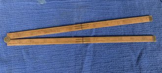

folding rules are great for layout work
This is its main advantage, when you need something to lay flat on your workpiece on the bench, e.g., laying out things on a stick, like cabinets, doors, entrance features, mantels, etc., and working with the project as you finish it. As others mentioned, the little slide out for taking inside measurements, but not all folders have them. I agree with the Europeans as well, they are more accurate at the 1/16" level than tapes. To me, tapes are great for rough work (carpentry) and longer distances. I used a folder (usually Lufkin) when working in a millwork shop for 25 years. All of us did. I think there may have been one tape laying around the shop somewhere for very occasional use. My work pants typically wore out the right rear pocket first, where I kept the rule.
I collect the old folders, like this Stanley:
