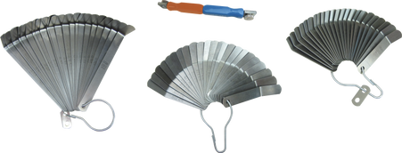

I have both Snapon set I purchased recently with nice mini screwdriver handles but for years I have been using a Mitutoyo set. But they aren't stainless so you need to keep them lightly oiled.
vwpieces
Apr 28, 2020
5,925
Hills, PA
If you are new to adjusting valves get a set of Go-NoGo type feeler gauges. Will help get an idea of the measuring and friction.
Or just keep the 3 sizes in hand while doing the job. If the clearance is 0.006" have the 0.005 & 0.007 on hand to double check your work till you get the hang of the locking nut and how much things change when tightened up. Finger tight nut and slight drag of feeler gauge at 0.005 might change to 0.006 with nut locked for example.
Not sure of the space on the F-350 but I have found the angled ones I have are used the most. I never really found any one brand to be the best, they all are cut from a uniform sheet or strip. But I do have a couple metric sets with Hazet and Stahlwille branding. Both of these come to more of a point before the edge is rounded.
A lot of my cheaper sets have been broken off or taken apart to use the blades individually. Mostly because the intake and exhaust valves are different lash and I want each size readily available, rather than flipping through the pack to the other size needed.
For my aircooled VW I only need 0.006 for valves and 0.016 for points. Here I use a double ended blade holder I think was made by Blue Point. Keeps these sizes readily available for quick access gathering needed tools for a job.

Any known-brand feeler gauges will definitely be fine for engine work. I have a nice stainless Hazet set but still use a really old normal steel set which I don't know where I got it from.
Brass ones also exist (I think so they're not magnetic and also don't rust?).
KnurledNut
Jan 28, 2011
8,179
n/a

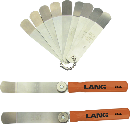

If you are just wanting a good general service set, I would recommend the Williams GS-1.
I have them and many other brands. Same as the Bluepoint USA set.
USA made and currently $14 on Amazon, which is around the price of similar cheap imports.

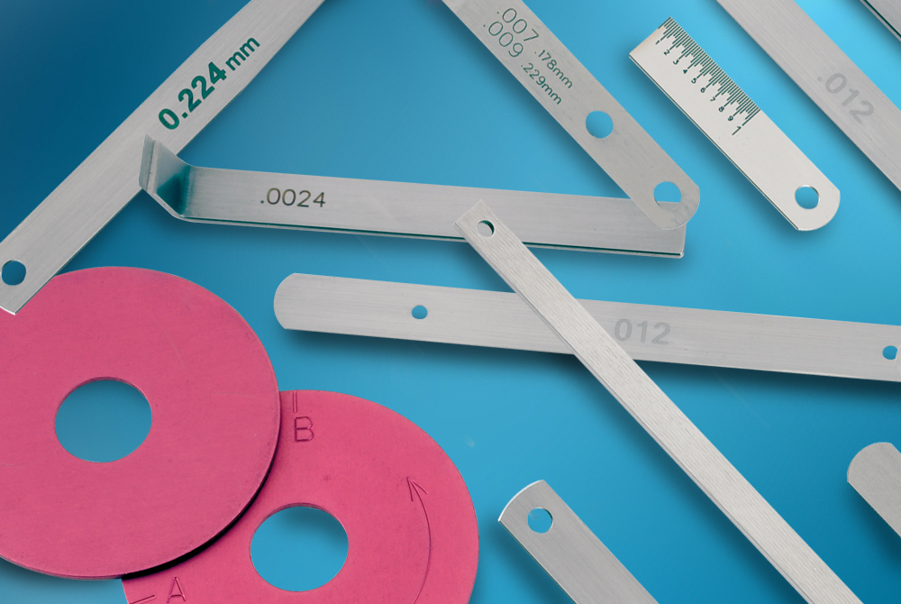

Just to add another digression to this discussion, here we are late in the year 2022, yet it's still remarkably difficult to find metric-only feeler gauges.
This matters mostly to those of us with metric motorcycles with shim adjustments, where the available shims and the specs are in millmeters, not barleycorns or bananas.
Inch gauges usually have metric equivalents marked on them. Better than nothing, but EXTREMELY error-prone.
Metric gauges are not too terribly hard to find, (powersports shoppes often stock nice quality sets under the "Bikemaster" brand name) but almost all are also crapped up with inch/barleycorn conversions, which only serve as added opportunities for error.
The only metric-only gauges I've found are in increments too course for many motorcycles.
One of my bikes, for example, has valve clearance specs of just .03mm - .08mm (no, that's not a typo or misunderstanding; the spec really is .0012" - .0031" for vintage 8-valve Suzukis), and shims are available in .05mm increments. Gauges thinner than .05mm are very hard to find, and ideally you would need .01mm increments up to about .15mm. The best I've been able to do is increments of .02 or .03mm. So you're left with the fine art of deducing actual clearance by whether the clearance feels loose or tight.
To give another example, my Yamaha FJ-09 specs are .26-.30mm (exhaust), and .11 - .20mm (intake), with shims available in .05mm increments. This is more typical for modern motorcycles, but note how the exhaust clearances are in a smaller range, and these are the clearances that change the most; it's good practice to set these near or at the upper spec where possible so that they'll stay in range as long as possible. (There's also the fine art of acquiring and saving factory shims, which are often found in very useful "in-between" sizes.)
A digital micrometer that reads directly in millimeters has really made life far easier as well; once in a while a shim is missing its faint markings, or I want to verify a shim.
Yes, it's certainly possible to do quality work in any measurement system available, including Klingon cubits. But sticking with millimeters throughout instead of farting around with conversions and constant math really does serve to reduce opportunities for errors.
What I would love, and would actually pay rather well for, is a service that could assemble custom feeler gauge sets, in clearly marked millimeter-only measurements in .01mm increments in the exact ranges I want. I'd happily sign up for a set specific for each bike.
