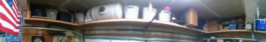

no pics of mine handy (it's similar to SZ's), but i just ripped 1/2" osb & made 2' shelving along the ceiling using 2x4's. it's not martha stewart-esque, but holds much more weight than the wire shelving or metal L brackets ever could.
having the extra floor space is great & i don't mind getting on a stepstool to access stuff, especially stuff that i'm not regularly using.
