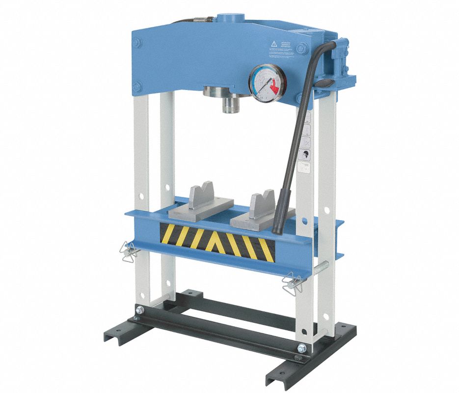

I use my press mainly for pressing bearings on and off of transmission shafts.
Buy a name brand to get quality. I had a Harbor Freight press. It was bent when put together.
This is a table top model by OTC. Rated at 16.5 tons it will out perform many 20/25 ton presses. You'll pay around $750 for this.
