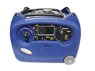

You can get reasonably priced Honda clone (Lifan) inverter generators at Home Depot for about $1500 for the 5600 watt most powerful unit (which will run alot of things in the house) or for as little as $500 for a smaller one which will power the sump pump and many other things if you rotate the power cord to the different things you want to use.
Inverter generators are much quieter than traditional generators, and sip gas rather than guzzle it like mechanical generators.

You can get reasonably priced Honda clone (Lifan) inverter generators at Home Depot ...
Another clone ... Boliy
Besides Amazon, these are sold by some storefronts and a couple of other internet stores. Some of them offer extended warranty.
