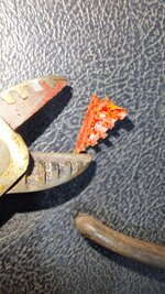

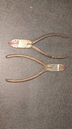

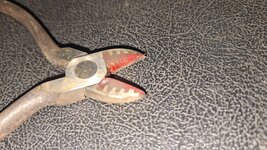

Here's a few I found recently. Can still read "CAM-RON" on top and US on bottom of pivot area

Probably. These are still intact, but pretty brittle. Im assuming they would just crack and fall out if I tried to use them with wire though.
