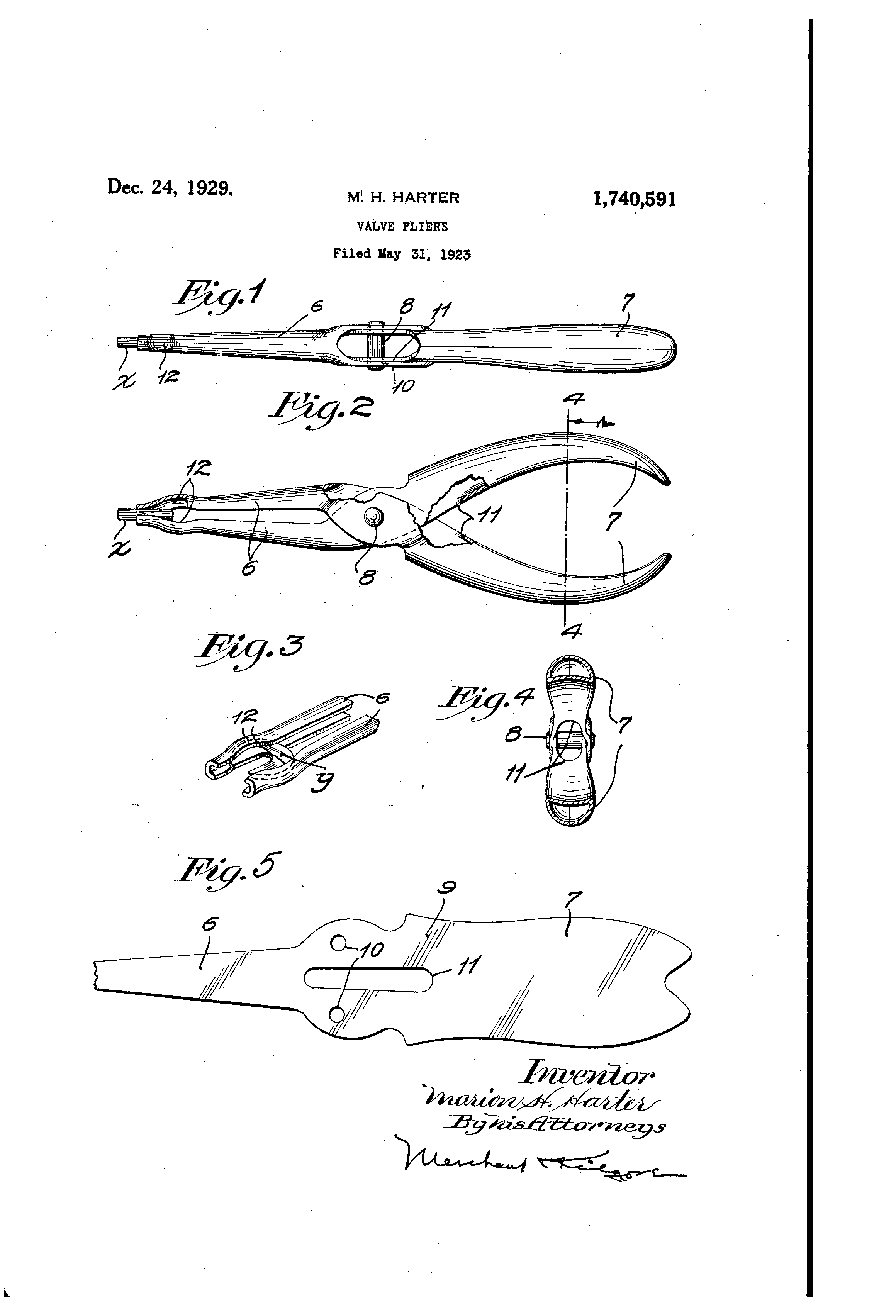

With the fulcrum pivot so far from the jaw tips (which doesn't deliver much force at the jaws), and with the pressed steel construction, I doubt they were designed for anything that would require a lot of force like hose clamps. They certainly don't look like your typical C/E clip pliers, all which have a pivot close to the jaws for maximum leverage force. Seems they were designed to reach into something to insert or remove a part where hands may not fit.
I'm really surprised that one of our members hasn't run into a tool like this before. But I think
MikeF2316 may be thinking in the right direction.
From what I could find, Douglass was exclusively parts and accessories mfr for the auto industry, including after-market items that car owners might buy and install on their cars.
Could they have something to do with valve work on early engines, which might be why we today don't recognize it? Like for the same reason old tappet wrenches are so long?
