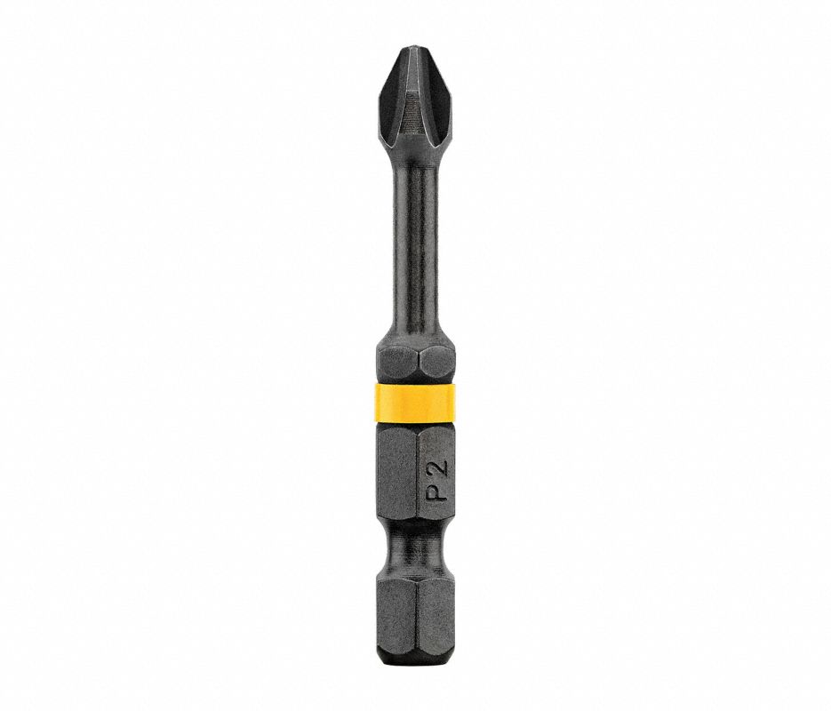

What is the advantage of a #2 "insert" bit?

I've always used these:
Meanwhile, in the Bargain area of GJ, posters are raving over the great pricing on these at fifty cents each:
20GX48_AS01
What is the difference? Does the smaller shaft fit different drivers?

No? They're the same thing from a size perspective.
The bottom one is impact-rated, the thin area of the shaft allows the bit to "twist" more absorbing some of the impact before it "springs" back. It'll also be a bit different steel in most cases.

New idea for impact driver bits - apparently they work better and last longer than regular bits.
You have to decide if they're worth the extra $$$.
+1 They work like torque limiting impact extensions in that way.
It just makes it less likely that an impact will snap the tip off. Though these impact rated bits are also usually forged and of better quality than their cheaper plain cousins.

If you look at the Grainger site The Yellow band only indicates S2 modified steel (that is as good as a wink to a blind horse) The blue band indicates High Grade Steel or Power bits.

Interesting. These look almost identical to the "harpoon" bits that I have heard were specd by Boeing for use in their factories. Is it the same concept - better for impact driving?
