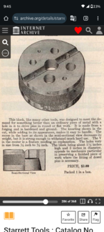

What is this? Came with a drill press

Bench block. You can use it for a bunch of stuff. The v-groove will let you put something round in it so it doesn't roll. The holes can be used to drive a pin out of something so the pin has somewhere to go. Or, on a drill press, to support a workpiece without drilling holes in the table.

... Being more of a metal guy than a wood guy.... Says it is for driving pins....ummm, what kind, why, and how?
Definitely a catalog for tradesmen - In the description "feature that needs no explanation"...I can guess the V feature might be for but no idea of the primary function of this tool.

It's function is to keep a tap perpendicular to a surface when hand threading or to hold a pin perpendicular for installation.
I dunno, but I would guess pins holding gears to shafts, and similar roles. Using a pin punch, driven by an appropriate hammer.
Oh yeah, those vintage catalogs were not for dummies. No description of how to use a tool, they assumed you knew your job. No Amazon flowery descriptions, or YouTube to show you how. That's what your apprenticeship was for. All four (or more) years of it.
But as soon as I saw one, I wanted it for many of the jobs I use my arbor press to solve, but with a smaller mouth.

A lot of mechanisms are held together with locational dowel pins. Driving these dowel pins out for disassembly requires a block like this sometimes, that' s why it's hollow on the back side. If it has a V groove in the center it's for holding round objects like shafts, gears, or spindles for the same purpose instead of them rolling around on a flat surface while trying to use a hammer on them. It's not for holding taps perpendicular if it's been heat treated, there are other devices for doing that.

Steel versions are, or at least were, a standard item in the US Army Small Arms Repair Kit.
Brownell’s used to make a steel version used in the kits, similar to the Starrett, but it has since been discontinued.

I just bought one of those. Pretty valuable little items.
I was rebuilding my milling machining and there are little mechanisms like the feed trip lever that are assemblies of shafts and levers held together with dowel pins.
My guess is the previous owner might have used it as a VEE block. Thankfully he didn’t drill into it.
The original finish was a caustic salt bluing which produces psychedelic swirly patterns of gold, brown, blue and purple. Clean it carefully with WD-40 and no abrasive and see what you’ve got. If it cleans up, I’d wax it and put it on eBay for $80.
